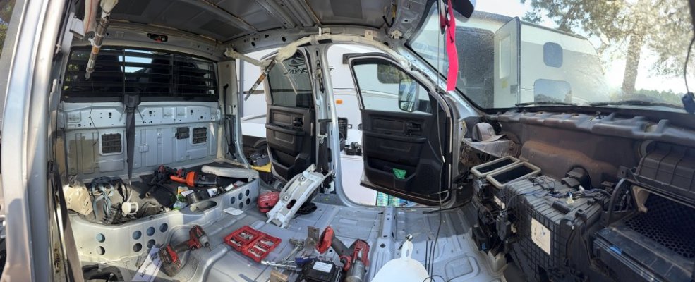

No, I did a tradesman to Laramie swap. I had to source a new interior harness. I checked the wiring 2 times before I installed it, but the damage was under the loom where I didn’t check. Next I do something like that, I’ll strip all of the loom offIMG_8923.jpeg

After I jankly taped up the gouged wire cleared the codes, the P2122 and p2127 cleared themselves on the test drive and the primary and secondary APPS weren’t fluctuating everywhere
