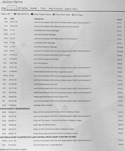

I have been having similar issues for about 3 weeks now. After driving for 15-20 minutes, the "Service Electronic Throttle Control" alert pops up and it goes into limp mode and maybe more. Speedometer stops, 4wd stops, Cruise stops, etc. Also, if I put the truck in park, it will not go back into gear. If I turn the truck off, it will not start again until it has had enough time to cool down. Anywhere from 5-60 minutes, depending on how long I drive in limp mode.
I took it to a dealership the Tuesday and they recommended replacing the ABS Control Module. Which is on backorder until April of 2024. Attached is a copy of the DTC readings. Not 100% sure I agree with that, especially after looking at others with similar issues, but no clear signs of a fix.
I called around and one dealership told me of a place called Module Masters in Moscow, Idaho that will rebuild the ABS module if I take it off and send it to them. I haven't called them yet to see though. Still looking to see if it could be something else.
