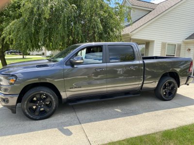

First post and super new to the forum. I’m 43 and this is the first truck I’ve owned. Turned in my Scat Pack lease last week for a 2020 Ram BigHorn Night Edition.
Love the truck but there are some things I certainly miss ...like actually hearing the Hemi. I didn’t expect 6.4 SP loud but I had a 5.7 Daytona that was about 3 times louder. So, the second thing I plan to do with the truck (new tires on Monday) is figuring out an exhaust. It is mind numbing though with all of the threads and opinions but one prevailing opinion is that MDS causes problems. This seems strange to me as my Daytona and SP both had MDS, would never drone, and had great stock exhausts. Anyway, glad to be here and looking forward to finding out more about all this stuff.
