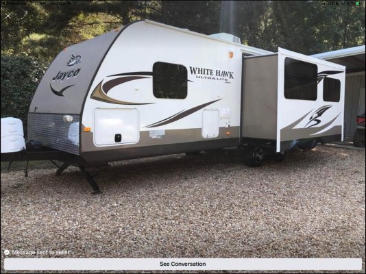

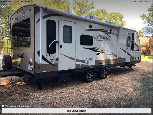

I’ve been digging for months, and decided to hold off on both the KTM and the TH. Decided to go forward with a regular TT.
Think I’ve found a winner...
[/URL]
5355# Dry, 7500# GVWR, Hitch weight 630. Includes WD Hitch and all the expensive bits that come with starting a camper adventure. Second owner, no repairs. WInterized religiously. Arctic Package, Electric Jacks, etc.
Pics:
Thoughts? Anyone had one of these???

Looks good. Ask/make sure wheel bearings have been serviced. Operate everything several times to ensure they work properly.

I think that's going to be too heavy for your truck. 7500 dry, so 8500+ with cargo (probably a lot more if you're living in it and collecting things as you go, or have water in your tanks + propane on board etc). 8500 * 0.13 = 1100 pounds of payload.
For a 4th gen ED, that's probably already right at max payload (my brother's ED has < 1000), and you haven't even climbed in yourself yet.
You may be able to make it work, but considering you plan to do this permanently and often, I personally would go smaller (or trade your truck for a used 2500 hemi).

As far as I know, they’ve never been serviced. It’s currently still apparently got the original tires on it. Date code 4313.

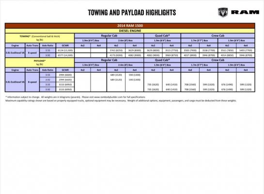

Maybe I’m reading the specs wrong, but it’s got a 53xx# dry weight, with a payload rating of 2145#, and a tongue weight of 630#. Truck is rated at 7600#. Fully loaded, I agree it would be a lot. As a travel nurse, I have a place full of stuff at home. I will travel with minimal tank fills and will be parked while I am on assignment. The jump to 8500# in your calcs is throwing me off. How does that correlate?
I have a lot to learn, so I’m asking questions to make sure what I’ve got my hands on.

here’s the chart for the EcoD...
4x4, CC, 5.7 Box, 3.55’s
He read your post wrong.
Good luck. It looks like a winner if everything checks out.
Safe travels.

GCWR 13500
GVWR 6950
Camper 5335 TW 630
What is your payload on your door sticker...so I can figure your base weight?
You will have to tow with the tanks empty...but you can fill and dump at a campground.

My bad, I did read your post wrong, I thought the 7500 was dry weight.
