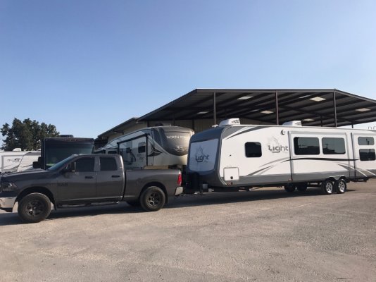

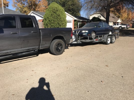

I'm very pleased with my 1211's and TGC 3/4" spacers. 5100s F/R with the fronts set at 2.1". Truck rides like a truck and doesn't squat near as much when there is a bit of weight back there. The hitched up picture is slightly deceiving since we didn't adjust the hitch for my truck (Parent's trailer/hitch) and my back wheels are sitting in a nice rut from the old man getting his 2500 stuck(2wd). The trailer also wasn't squared away for transport (gets used as an office and guest "house") so we roughly figured it was sitting around 900-1k on the hitch. I liked the level look it had before, but it was worthless when I needed to do truck things unless I wanted to ride around with that stupid noise high squat and a floaty front end on the highway. Since I took this picture the truck has leveled out just ever so slightly, but still handles that kind of load no problem.
