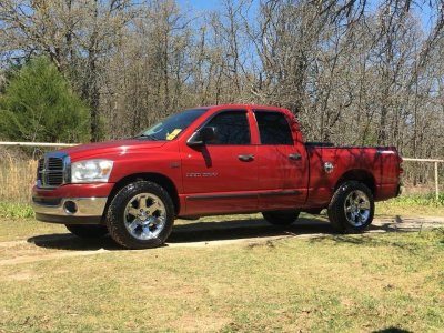

The first thing I did to my 07 RAM 1500 Bighorn when I got it was to slap in a DIABLE TUNE. I turned 'OFF' the MDS and installed the #1 settings. Tightened everything up. It has almost 300,000 miles on her now and still going strong....(not to mention a Hemi with a Flowmaster exhaust system and functioning MDS, sounds like a busted Mazda. It had to go!)
