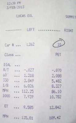

Making a run down the track with Bill. He has a rear mount turbo, 426 Hemi (6.1 stroker). His truck runs 12's all day long. He only gave it half throttle running my 03...
Bill picking on a brand new Stingray. :waytogo:

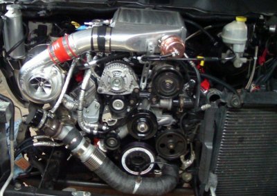

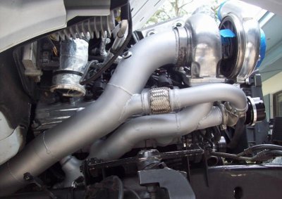

Cut up the rear mount STS kit and built a front mount turbo setup. Went from running a best of 13.8 with the rear mount STS turbo kit. To a 13.1 with the front mount turbo running the same 8psi boost in full street trim at the track. The truck had better power all the way around.

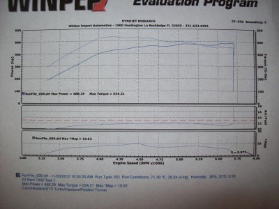

Did a dyno check. Stronger hp/tq. 488hp/534tq. Not bad.

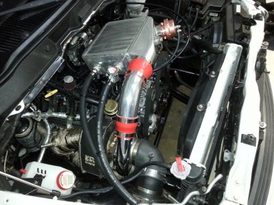

Finally got the turbo setup the way I wanted it and raised up the boost to 12psi.

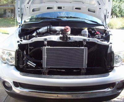

I love the simplicity of the Air to Water IC setup. If I ever go boosted, I think that's the path I'll take.
I love the progression. You might plumb in an ice reservoir since you seem to like drag racing,

Thanks. Currently working on my 05 turbocharged 392 Hemi Ram regular cab. It will have an ice reservoir.
