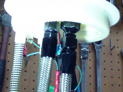

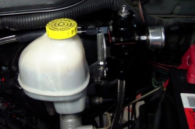

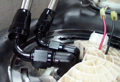

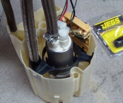

Whats your fuel system set up like?
Hellcat in-tank fuel pump, -8 fuel supply braided s/s hose to fuel rails and to the fuel pressure regulator. -6 out of the fuel pressure regulator back to the fuel tank. Running at 58-59psi fuel pressure. Accel 80lbs (43.5psif) injectors. It was tuned with the fuel system at 58-59psi fuel pressure.

Looks good Stu..

Thats a nice fuel system set up, very clean. Its hard to find pictures on these trucks about people setting them up for a return system.

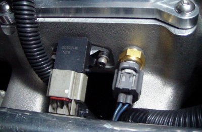

Installed the IAT sensor in this spot next to the map sensor on the OCP intake manifold. There was a threaded port there and I didn't have to lengthen the IAT wiring plug. Will test it out in that position.
