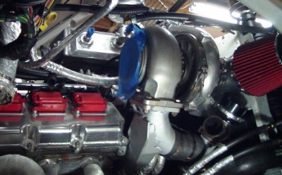

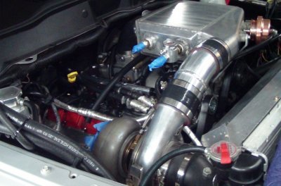

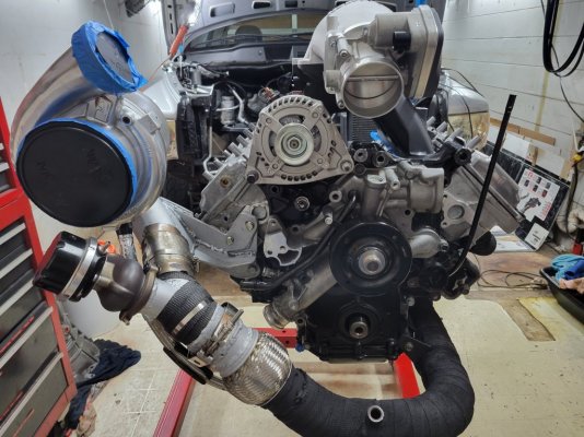

Setting up the 4" exhaust system back to what it was with this GT45 80mm ball bearing turbo.

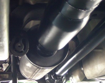

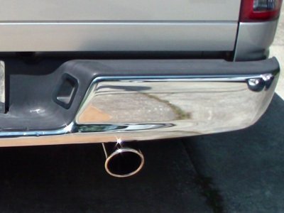

Went ahead and installed a Dynomax muffler to clear the spare tire at the tail pipe. Also installed a Dynomax race muffler ahead of the second muffler. They got rid of the drone and quieted down the exhaust sound with no power loss. All diesel performance mufflers are 4 inch in/out.

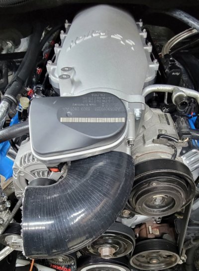

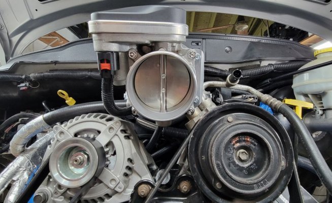

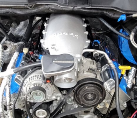

Found what was causing my tuning problems. POS BBK 90mm throttle body... Runs better and steady with the oem 80mm throttle body. The rv/turbo street cam has a great mid to upper rpm power band. Feels surprisingly strong with just 6psi boost. Have to install the iat sensor in the intercooler and a few more small things. Other than that, it's ready for a new tune.

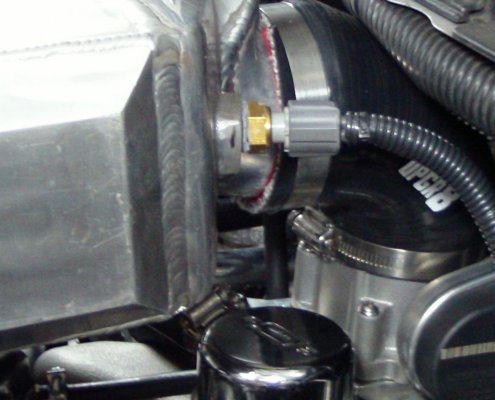

Had to move the iat sensor to the intercooler outlet. Had to make sure it's far enough away from the w/m nozzle.

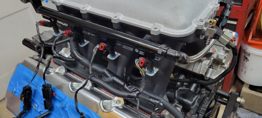

Not a simple install.
