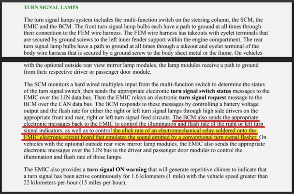

The sound you hear is the relay clicking on and off for the turn signal.
It definitely sounds like a relay, but I have yet to locate it in a service manual. :cool:
IIRC, I did search for the relay. Or, was that 25 other things I was looking for?
Then again, it almost seems like they use irregular terms to conceal various components.
How many terms can we use to search for turn signal relay? :rolleyes:
Found it for a 2013-2016 Ram 1500.
The EMIC is aka the Electro-Mechanical Information Center. :cool:
