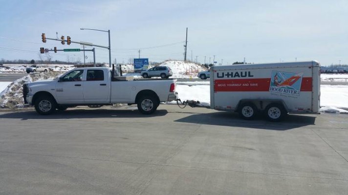

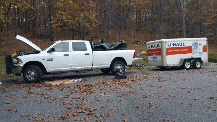

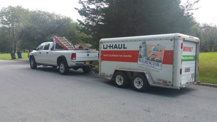

I dragged U-Haul's finest (sarcasm) 6x12 trailers from North Jersey to Roanoke VA twice and N Jersey to Knoxville, TN once. Loaded going down, empty coming back. Truck was loaded too, in & out.
If you load it right, tires and tire pressures are good, they follow you quite nicely. I forgot it was back there coming back empty.
Of course, I was pulling them with a '17 2500, 4x4, Crew Cab, Long bed with a 6.4 and 4.10 gears that empty, weighs about 3/4 of a ton more than your truck. :)
Pics are from 3 different trips. One of them (with the Quad) I had that sucker waaay over loaded. Just trying to show how they all sat relatively flat.
You should have no issues with your truck. Just tow smart, not fast.45f4112099201e511da2c894e06363de.jpg3003018ecd0eae469bd485ff5e41ad76.jpg5e9c8e1a5a053011e385a0f7689f8306.jpg
