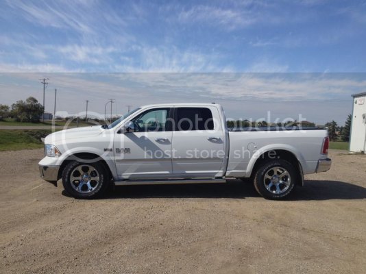

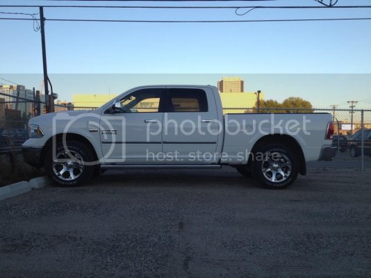

Measurements from the ground to the top of the fender are:
Front: 39 1/8"
Rear: 41"
I still have 2" of rake as I pull a 28' 5th wheel and did not want to be nose high.
Before:
After:

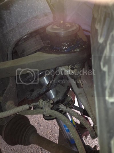

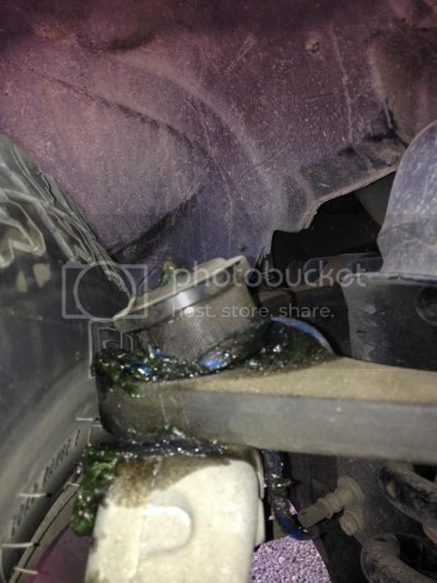

Well........48hrs later and the passenger upper ball joint failed. I had wheel alignment done yesterday morning drove the truck home and felt some clunking when turning left. Thought that perhaps something wasn't tightened from the alignment. Keep in mind I drove only on pavement and did no off roading. Crawled underneath and located this....
So now Mevotech warranty will kick in and will replace the passenger side UCA. I hope this is not the beginning of a headache of front end problems. If that's the case Bilsteins will be set to 0 and will install the factory UCA's again. I'm assuming this is a manufacturing defect. Anybody else had upper ball joint failure this fast? I replaced the UCA's in order to avoid this problem all together and here I am 48hrs later with a failure....Junk!

Ok after looking at arms on rockauto, it seems they are pressed in like OEM.
Did you order right and left hand UCA's? Im grasping at straws here.

Often times, when a BJ is pressed from the top, there is a snap ring to retain around the bottom. I wonder if this was perhaps left off in this situation by the manufacture.
I highly doubt this will be a continued issue, and was merely a manufacturing flaw.

Ball joints are pressed in from the top so the failure makes sense that way. In regards to the left and right UCA's, I had different part numbers for the left and right in sealed boxes, so they were installed on the correct sides. I ordered part# MS251057 & MS251058 (Left and Right UCA), which has been posted as the correct UCA's although not listed for the 2014.

Look at the grease fitting on top... couldn't press it in the other way.
