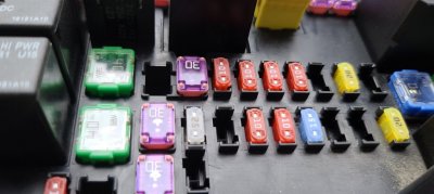

Wild guess here, I had radio freezing, not coming on at all, weird characters, stopped reading thumbdrive in the middle of a song etc. I had an issue where the truck would not start and found that all but 1 fuse was not pushed in all the way. After pushing them in, been 2/3 months without a single issue. Also cleared other "weird" stuff
This is when I was about done, you can see the yellow fuses and a red one sticking up just a hair
