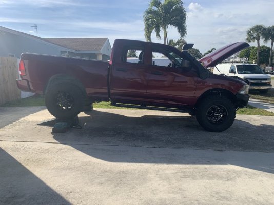

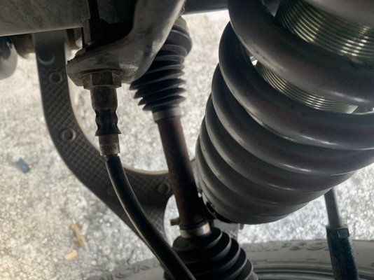

Talk about close on the cv axle to the coilover. Not even enough to squeeze a pinky finger in there. Lol. Back to 3” front lift. 1” rear. Rides so good. Almost has a luxury suv feel to the ride. A little more roll in the turns. I did reinstall my rough country top spacers with these to give me the extra 1/2” lift. Going to start getting metal to at least build my rear bumper. Winch cradle is dependent on if I reuse the front bumper and cut it up or completely build my own bumper. I’m leaning towards the latter honestly. I want tube style ends with a beefy solid middle for the winch. I had plans for a rear bumper around the same concept but unsure how I want to do the license plate lights and trailer plug. May try to keep the stock license plate lights. Do I want to keep the stock tow hooks up front? I was planning on adding clevis mounts so the hooks may just be removed to make the bumper design easier

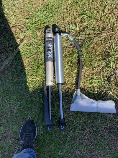

Surprise surprise. Christmas came early. These things are beastly. For future reference I turned them 1.5 turns to lift the truck higher. It is 7 threads showing above the ring.
Edit: have to take it all back apart. I drove it to settle the suspension and I’m at 39.5” driver and 40” passenger. 41.5” rear. So I need to turn the driver up 5-6 turns and the passenger up 3-4 to bring it around 40.5-41”
Edit2: turned it up 6 on driver and 4 on passenger and new measurements are 40.5” to ground. Was hoping for a bit taller but I may try to find a way to lower the rear a bit since the fox shocks are a pinch short anyways. Anyone know the spring rate and lift height for icons or any other springs? Trying to keep a tad higher load over stock since I do use the truck. @ram1500rsm any ideas? What height are the 5th gen ORP springs? Or I can always cut 1/2 a coil off of these springs.
Edit3: this is bugging me to much so I’ll be adjusting the front Monday. Up 3 turns on both sides.
Wooo woooo, Enjoy the new puppies :)
To answer your question, I asked a few people to experiment with the Clayton springs over the 5th gen forum back in 2020 and i also asked for measurements on the ORP's, Not sure about spring rates but they don't seem to support much weight just like our springs :)
Anyways the ORP rear springs are 20.25" long, and they provide 1" over the non-ORP versions.
In contrast, the Icon 1.5" springs are 19.5" and they provide around 0.25-0.5" more lift compared to the ORP's
in theory around 1.5" int he non-ORP trucks.
Claytons give them 1.5" more than ORP, 2.5" on the non-ORP trucks
Have fun.
Just out of curiosity, how do those fox coilovers ride compared to my icons? Any striking similarities or differences?

These ones are custom tuned so not regular fox. They are definitely a bit softer than the icons for everyday driving but I think that’s partly due to the 550lb springs instead of the icon 600lb springs plus these are valved for daily driving weekend off-roading and not straight off-roading. Otherwise they don’t mind hitting bumps or divots in the road and they corner a lot softer than my bilstein did. I’m a little light compared to what they valved for because I want to add my winch and rear bumper so another 100lbs front and rear should soften the ride up a bit more

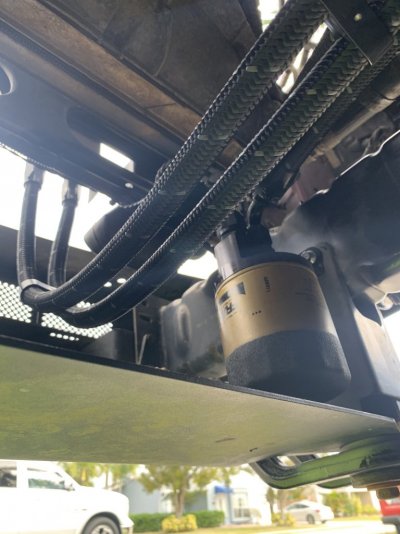

A tad bit rear high for the trans. Lmao. Time to get started on the thermostat.

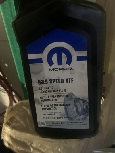

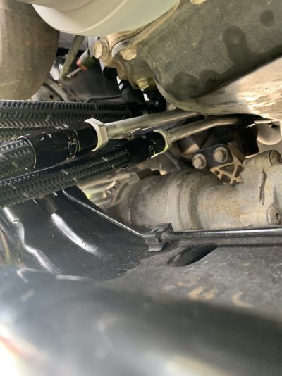

Dang. 2 quarts of trans fluid wasn’t enough. That’s all I had left in my stock. Will have to get more so I can finish.
crazykid1994
crazykid1994
Sep 21, 2013
5,063
5,064
Florida

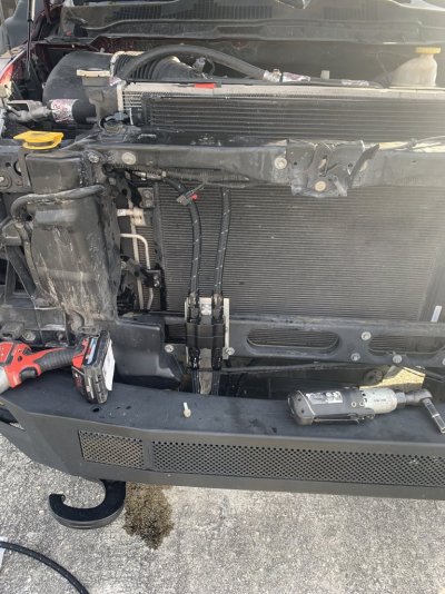

3 quarts guys. Took 3 quarts… new transmission lines with -8 a male ends and an in line 145° thermostat and I’m all back together. Well just shy of 3 quarts but non the less. Will report back after a couple drives but idling in my driveway it definitely warms up faster. during my fluid check went from 76° to 86° for my check then after checking made it to 92° and sitting am now at 100°. This is all in under 10 minutes. Also $39 a quart from the stealership.
