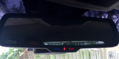

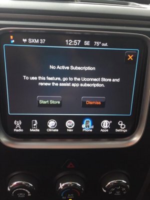

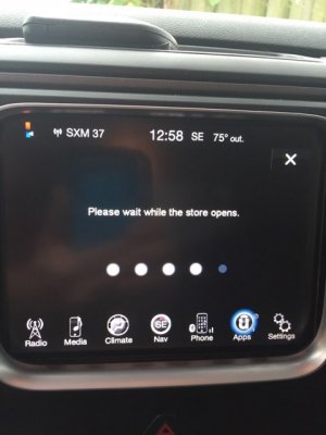

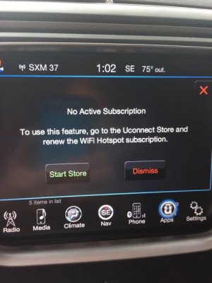

Well the mirror came in today and the truck sees it. You need the subscription for the uconnect for the assist to work but the truck sees it and the 911 button works and so does the microphone in the mirror. So far the device mirror error has gone away, but I only started the truck 4 times. Automatic dimming mirror I am not sure if it works as my back window is very dark. Here is a couple of pics of it.ImageUploadedByTapatalk1416248319.757355.jpg

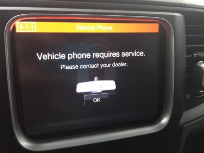

The vehicle phone needs service error showed back up, but went right off. So I am not sure on this one. Maybe the update will take care of it?ImageUploadedByTapatalk1416249219.128538.jpg

Nice man ! Worth trying to find one you think?
Rherman1
May 9, 2014
476
51
Sunny Florida
6.7 Cummings
If you can get it cheap enough just for the 911 capabilities and the auto dimming. I picked one up for $65 including shipping. Happy hunting!

You have to have the uconnect subscription I believe. I haven't tried it in a while.
