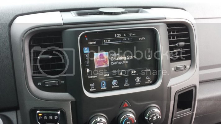

I swapped my 5.0 out to the 8.4 with nav. the climate control does not work but it shows the temp and the fan level on the screen. I get a have phone serviced error that comes up once in a while when I start the truck. But our good friend cgeorgemo explained to me that the other truck that has the 8.4 has the 911 and uconnect access on the mirror my truck doesn't. Other than that the nav shows up in the cluster and everything works fine so far. I change the volume and channels from the steering wheel, you can also change the channels and put them in manually from the touch screen.

If you have the 5.0 then you'll already have the correct antenna on your truck. The satellite radio antenna is also the GPS antenna. I didn't need a flash on my truck at all for any of the audio upgrades I've done.
The steering wheel controls worked fine plug and play and the 8.4 RA3 and 8.4 RA4 worked fine plug and play without any dealer involvement besides the anti-theft unlock code.

I have one of the 8.4 bezels. The wire harnesses are different. No common connections for the climate control or the knobs for the radio.
The climate control is a totaly different type of connector as well it has surface contacts not pins.
