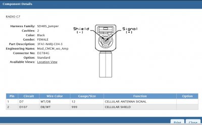

What wiring diagram? The tech authority wesite shows four of them being used
C3 AM/FM
C5 GPS
C6 SAT RADIO
C7 CELLULAR

What wiring diagram? The tech authority wesite shows three of them being used 1 for AM/FM 1 for Sat/Gps and 1 for cellular.
I didn't see the cellular antenna, Can you tell me where on the tech authority site?

Nice, where do the ends of the connections go to? Is there a pigtail or a different antenna? Pictures will help, thanks. I did see the website Just didn't realize that was the Tech authority site, thought it was Chrysler. I have the yellow and white connector, I just need to track down the brown one where it goes to. I dont know if I need another antenna or a pigtail somewhere.

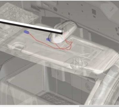

If you look up the premium sound and look at the antenna on the tech authority website, the 3d model the antenna shows 2 pigtails. Also the third antenna on the pic of the vp3 seems to show those 2 wires running together.
Also if you look at the cellular one its the same picture.

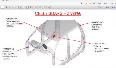

At this point I am only guessing but I belive at the least we need a sister cable to the sdar antenna from the radio. and possibly we need a new antenna that supports both. If one of you has the time and a good parts guy, take the vin from a truck with the vp3 or vp4 and have him look up the parts and share them with the rest of us.

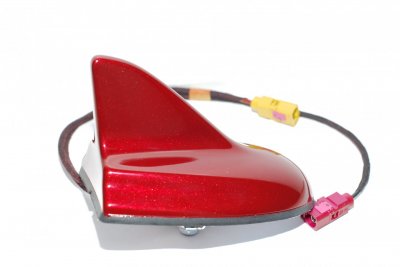

Here is a picture from this forum where jeepguy 1980 painted his (sharkfin), notice the two leads. The yellow one is for the sat/nav) the reddish one is for cellular.
I think I found all we need to do this. Check out this PDF
http://www.rambodybuilder.com/2014/docs/cc/dddpsrca.pdf
Now who is gonna buy the parts and try it???

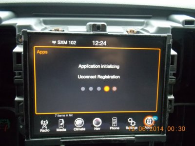

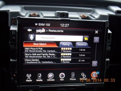

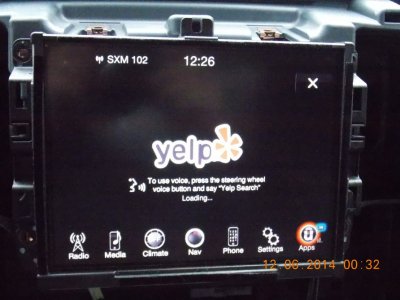

Well I hooked up the shark-fin antenna and guess what it works. I went from no G to 3G. Note the cicle with the line through it next to the APP button in the first pic. In pics 2, 4 and 5 notice it now says 3G. Also pic 3 shows mirror without red light on, and only turns green when I press assist, I was too nervous to try 911.
I was not able to register with uconnect yet, but I was able to connect to yelp.
NO CELL SIGNAL
CELL SIGNAL 3G INITIALIZIN UCONNECT REGISTRATION
NO RED LIGHT ON MIRROR
YELP SEARCH
YELP FOUND
