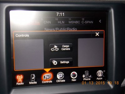

Ok, I have some questions about the behavior of this unit. When I first installed it the radio did not turn on when using the remote start until I physically opened a door, whereas the 5.0 would play as soon as the truck was started. I have since installed RAX jail-breaker silver and now when I use the remote start the back up camera activates on remote startup, and will stay on until I either touch the screen or put the fob in the ignition and turn it to run. I should note that the radio did and still does a normal boot up when I start the truck normally.
I also installed the auto dimming mirror with the assist / 911 buttons, I am not sure if the auto-dimming is working. I have noticed that on screen shots of the radio on the web that in the controls function there is a incon for the auto dimming feature, prior to installing the RAX I did not even have the controls function, now I do but it only has the cargo cam icon which is what I was after anyway.
The below pic is jeepguy's post when he added the cargo cam, notice the mirror dimming icon?
This is mine
I, thinking there may be a sales code required here, as you know the mic and phone buttons function fine. Any insight here, is there a sales code has anyone added it?
FYI jeep-guys truck came with the 8.4AN. And I must say the OEM boys did a great job on the bezel, just feel sexually violated by the price.
And one other item that has me wondering, were any of you able to retain the factory apps? IE slacker, I heart radio, ETC?? And before someone comments, I have the shark fin antenna being painted at the dealer to match the truck that is why I have no embedded cell signal.
This is mine
Was the mirror installed before you flashed the RAX?

Yes , the mirror was in prior to RAX, I actually installed the mirror for the RA2, which I originally upgraded to because at the time I did not know I could upgrade to the RA4. (my truck came with the RA1) What I want to know is if I have the GN5 code will the autodimming function show up in the controls panel, and is the auto dimming function working on the mirror? The phone assist buttons work and the microphone works just not sure about auto-dimming.
Does anyone else who added the mirror have this button in the control panel, most of you like do not have the control button, I did not until I added the jailbreak and installed the cargo cam.

Yes , the mirror was in prior to RAX, I actually installed the mirror for the RA2, which I originally upgraded to because at the time I did not know I could upgrade to the RA4. (my truck came with the RA1) What I want to know is if I have the GNK code will the autodimming function show up in the controls panel, and is the auto dimming function working on the mirror? The phone assist buttons work and the microphone works just not sure about auto-dimming.
I added the mirror yesterday, and do not have a control button. Gonna try reflashing the radio with the factory firmware again and see if it kicks it to pick it up.
