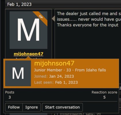

Appreciate the catch, @RamDiver! Apologies on my end for any confusion.
Well, if this user ever happens to come back online, at least they'll know where to find us.
Hannah
Ram Cares
LOL, they sometimes come back after a few months, but not too often after several years. :cool:
No worries, I thought you might find that last seen window useful.
When someone resurrects an older thread, many of us get caught.
