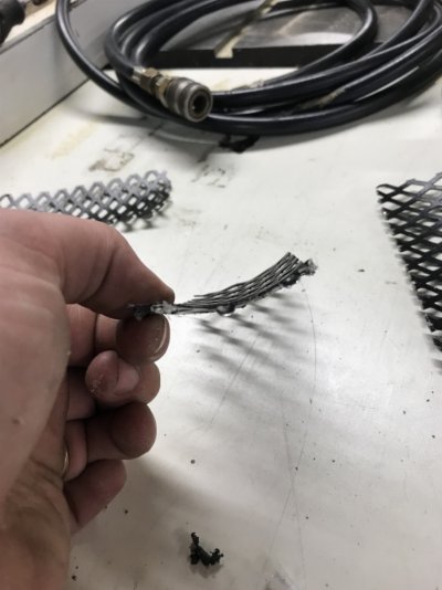

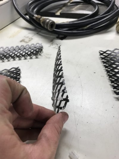

Go to the member section, and they have member trucks/build threads. That’s the place to start. Throw up some pics of your truck and go from there [emoji1303]
And don’t do the gutter guard for the speakers. It was a big fail. The sun warped them all and I had to pull them out. I’m kind of at a loss on what to use, may make them out of thing mesh metal when I have time
