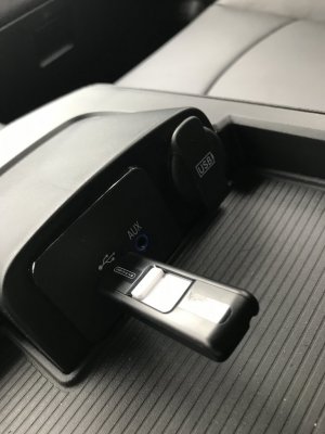

Make sure your plugging it into the data USB not the phone charging USB which is under the flap, do it as shown below
