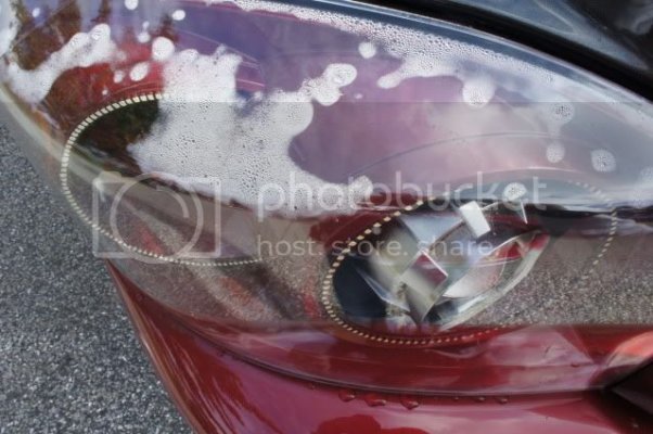

So, I was supposed to meet up with Froggy on Sunday at the Frog Cave. So, I just went outside to wash the truck (heck of a nice day out), and it appears my passenger side head light is holding condensation. And, on top of it, neither light will work! Fuses are all good...first thing I checked. So just talked to Unique Coatings and I have to send the light and the harness back. I just find it odd that now I am having this issue. I've had these lights on the truck since the winter, and never had an issue!

Sorry to hear that dude. I hope that gets fixed asap!!

When I did my 08 - they were fine for about a month...........then BAM, started fogging up. Pissed me off! I pulled them back off, resealed, reinstalled. I think I did that 4-5 times. Wendy has them now, no issues (so far) with fogging.
I will say this - I used buytl tape on my set and Jay's set. I have absolutely no leaks on these. I doubt they'll ever leak too..........there is a SOLID 1/4" "bead" of this tape around the inner part of the housing to hold the lens in. That ain't leakin'! I found with RTV you can't lay down a solid bead, which is going to lead to air pockets.
Now, with that being said - I haven't done nearly as many as Chad has. Or at least what I think he has done (I thought I heard that he sends them out to get done) - either way, good luck with it! It sucks.........and the first time you walk out and see your high priced lights looking like that...........well thats enough to make you want to smack a fool!

mine did it for a bit and I just ran ANOTHER bead of RTV around it and no more problems so far (knock on wood)

Same thing I did on my 08. They leaked again.
I even put rubbing alcohol in the light (as it evaporates FAST and doesn't leave water spots inside the light) and watched where it was leaking from......sealed that.......and they still fogged up.
Very annoying.

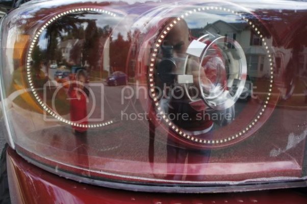

Those were the halo install. thought so. I'm glad and happy with my stockers. However the pass. side was replaced all together, and with the cool nights and warmer days. now is the time too look for this stuff. At least your teaching them young dan. (reflection has your kid looking on) sweet imo.

LOL I didn't even notice he was in the picture.

^^ nice neighborhood too.lol.

ha stalker, for that truck, lol. Thats a bad ass paint job, still have the photo from carlisle.
