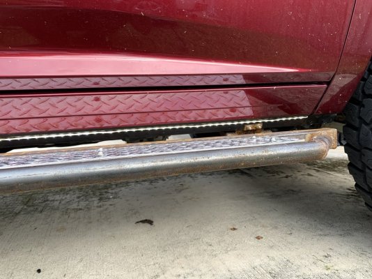

That’s for footwell lights. They come standard in the higher trim level. I actually used the wiring to feed my lights for my truck steps instead of taping the cargo lights. It works great because they’re on with a door open or when you unlock the truck and they fade on and off.
