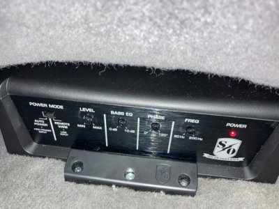

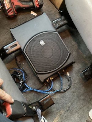

Here’s the sub I installed. Just fits under the seat. You’d never know it was there if you weren’t in the cab listening to it. Doesn’t affect my storage space behind the seat at all. Plenty of power for a truck cab, but not obnoxious where all the neighbors hear it either.
