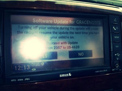

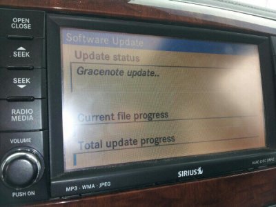

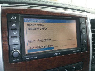

If there's any 730 RER owners that need an update, or anyone that wants the latest gracenote update, let me know.
