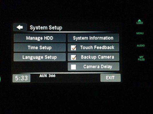

checked the current software, was at 33.00.41, so I burned the update to a DVD, went outside, fired up the truck. By the time I was finished having a smoke, the update was done, now I have epic black theme! Really does look better, I don't know why they had a blue theme on there to start with. Unless your truck is blue, there's literally nothing blue in these trucks haha

Found out what the camera delay feature is. Since its new on mine. Its for when you backup for a while and change back to drive the camera stays on for a bit longer that instant switch back like before to drive. It does have a red X in the top right hand corner if you want to go back quicker.
