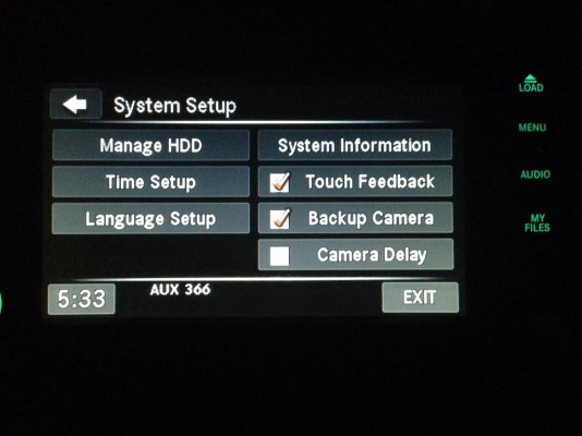

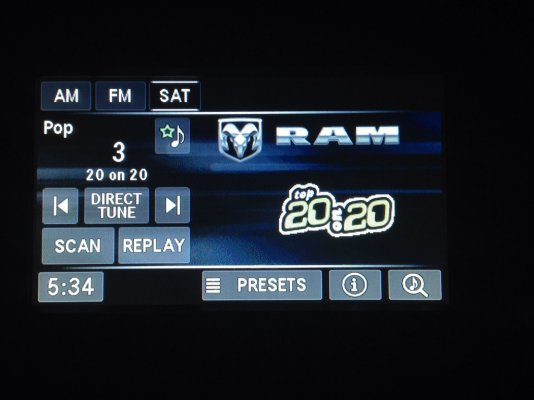

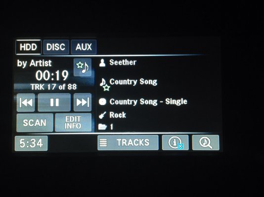

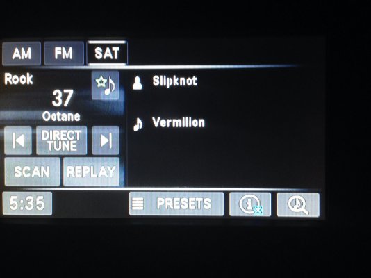

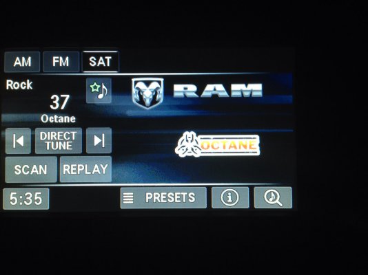

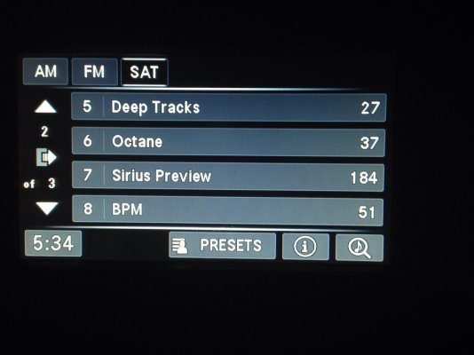

done and succesfull. It seems I have more highs than lows. So I have to adjust my sub amp now. I like the flat mostly black look. Everything works just the same and didn't loose anything on the hard drive. Whish was good because I have 28gb of music I'd rather not redo.
Some screen pics from my phone. Click to make bigger.
Just have to figure out what the Camera Delay option is now.
