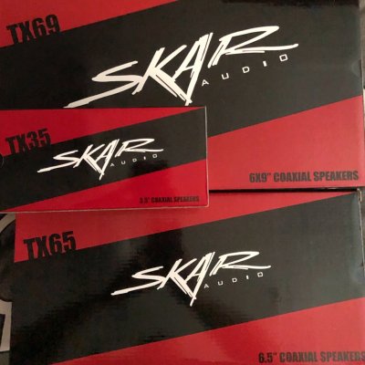

I too was about to order the Kickers after upgrading my head unit last week. My buddy reminded me though that you are paying more for the name than you are the speaker. He turned me on to Skar Audio that he runs in every car him and his family own. (A lot of cars lol) I paid like $145ish for all 6 replacement speakers. And not just their entry level speakers, I went with their high end ones. I haven’t installed them yet but the quality looks amazing. I can’t wait to hear them. b6e8568e7e57fbfc6e50a0dcbf4277e2.jpg
