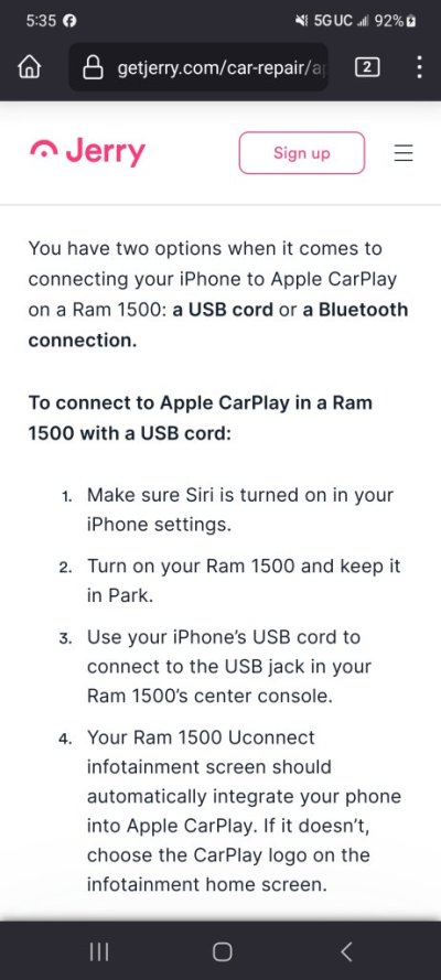

I don’t know how to enable it on my phone other than going to CarPlay and searching for my vehicle. I have the “enable projection” box checked on my uconnect.

Should Bluetooth be on or off when plugged into USB port to get CarPlay?

Which I Phone do you have?
How do I activate CarPlay on my iPhone?
If your car supports wireless CarPlay, press and hold the voice command button on your steering wheel to set up CarPlay. Or make sure that your car is in wireless or Bluetooth pairing mode. Then on your iPhone, go to Settings > General > CarPlay > Available Cars and choose your car.Aug 22, 2023
If U not have higher trim, then plug in USB into port as opposed to the wireless stuff. I have a lower trim Bighorn not have wireless capability on Carplay.

Just FYI, I can only connect to my radio through Bluetooth. If I tune my Bluetooth off and plug my phone into the usb, my radio doesn’t connect to it.

Do you know anyone else with an iphone or android that can try to connect to carplay or android auto?

My my wife just got new iPhones yesterday. I’ll try hers but I tried her old her phone last week as well with no luck. I don’t know anyone with an android or should I say close by me.

The only thing I can think of replacing is the wiring harness but is there any way of knowing if my existing harness is the wrong one? Are there specific colored wires or number of wires on male adapters that plug into the USB hub? I’m about done throwing more money into this thing just for CarPlay unless I know it will work.

I'm not sure what else to try at this point? I was convinced (given the symptoms) it was most likely the hub but that doesn't seem to be the case. I did this upgrade to my 2016 with no issues, just needed the correct USB hub and the harness adapter for it and everything worked (android auto and car play).
I didn't go back and read again but did you try a different cable (a genuine apple cable)? That's about the last thing I can think of.

Update: It’s working now. Being I got the new iPhone 15, they don’t use the old cable now. It’s a USB C and i ordered the USB to USB C port so I could plug it into the console using the cable that came with my phone. I was using 4 different cables with the USB to USB C thinking one of them have to work but unfortunately they didn’t.
I really appreciate everyone’s time and effort helping me. I can’t believe it was a damn cable issue.

Those apple cables/lighting cables and hook ups are finicky PITA, lol. If U have your phone plugged in and connected, and turn off vehicle, but leave phone plugged in. Then go back and start truck back up, sometimes the CP may not connect and U will have to un-plug then plug back in. Just how it is and how the modules power up and "see" things. FTR, I got an I Phone 14, and it does it sometimes. It may not on yer I Phone 15, but if it does, do not be surprised. FYI.
