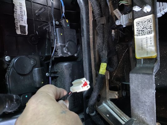

Yesterday evening I installed the upgraded 8.4 with Nav/Carplay in my 2018 Ram 2500. My truck was already equipped with the correct USB ports in the center console. The radio itself is much better except for one issue. I’m not getting the CarPlay feature. So I have searched and searched, I tried 3 different iPhone cables, made sure that CarPlay wasn’t restricted in my phone but still nothing. My phone works using CarPlay in my wife’s car but in my phone settings CarPlay isn’t recognizing my truck but it does my wife’s car. The radio is definitely CarPlay. The original owner of the radio used it. When I took the front plastics off to remove everything, I noticed a white plug that wasn’t connected to anything. It might not have anything to do with my issue but if you know what this plug is for, let me know. I attached photos of plug and sticker on back of radio.

That plug I think is for a cigarette lighter plug maybe (not sure)? It's definitely not the USB port or anything to do with it. The Micro USB that goes to the USB hub is the gray plug on the back of the radio.

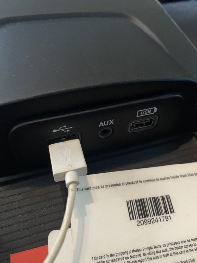

This is the USB port I have.

Snk is correct, wrong hub.

No offense but that seller doesn't know what he is talking about. That VP3 radio did not have car play and you need the correct USB port (which it appears you do Not have) You might need the harness as well. They are not all compatible with carplay, only certain ones have the correct wiring. Yes they will all charge and connect to the radio, but many will not work with car play.
I suggest you take a step back and read this thread... It has info on the compatible USB ports
