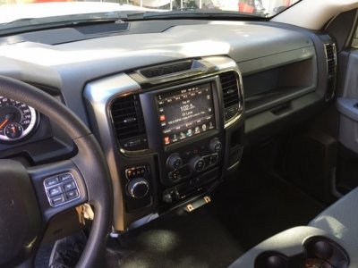

Bought the katzkin on eBay for crew cab it was cheaper than buying for a regular cab

Autotecheletronic in Laredo Texas for the push start so you can leave key in your pocket

Bought slider on eBay new comes with motor had to buy plug for wiring motor from dealer bought over head console on Craigslist plug on console has five wires power little wire goes to litchi switch for interior lights one ground other 2 go to motor for slider it’s really easy to do had glass shop come to house they pulled old out put new in for 90 dollars

709 dollars then I ordered the door handles with harness couple weeks later that was 600 total for everything was 1309 no dealer needed at all they put your vin into box keys are already to work

A lot of the upgrades came with instructions switch just pops out or you can change the wires at the motor wires will come out of the plug you just have to know how which is hard to explain

On the folding mirrors got the mirrors for 100 had to buy the two door modules and the new switch then bought the obd programmer from Infotainment I have 700 in it all infotainment wanted 1300
