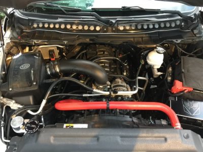

Haven't had any trouble with the snorkel, water, snow,etc...I run the S&B dry filter with their filter sock. It's the best CAI system unless you go with Vararam
