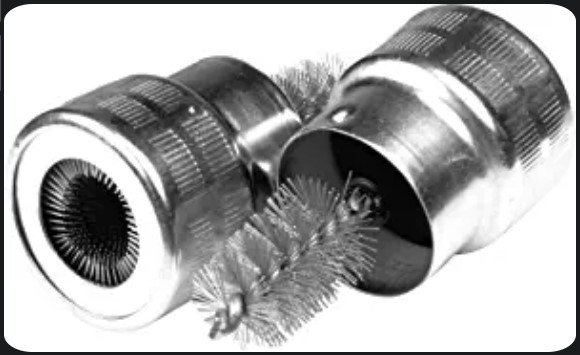

My favourite tool for battery maintenance will always be the post/clamp cleaner. If you drive anything longer than 6 months in a variable climate, how could one not justify this expense?
I can buy them in Canadastan for less than $10. :cool:
I don't think I know any guy that doesn't have a couple.
I know that I have 3 of them.
Years ago, I would occasionally misfile tools and when they're so cheap, why not just replace it. They were about $5 up here, must have been about $2, stateside. :cool:
I'm surprised at the number of vehicle owners who have never had the pleasure of using one of these devices.
I was hooked after the first 30 seconds of use. They're just so efficient and effective for the purpose.
Now quick, everyone rush out to Harbour Freight or Princess Auto and get one of these, if you don't already have 2 or 3 of them. :cool:
