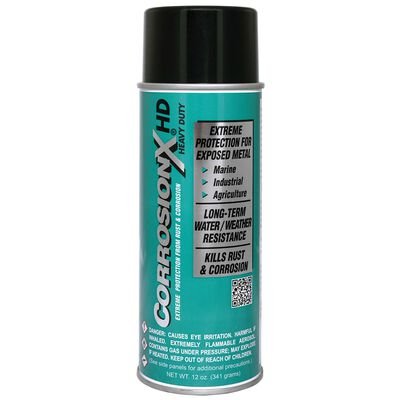

I use Corrosion X on my terminals. That stuff is like magic for inhibiting the lead sulfate that builds up. Clean the terminals really good, then spray some on a paper towel and smear it around the post. Don't try to spray it directly onto the post as it can be kind of messy. For my marine batteries, I clean them then pour a mixture of water and baking soda on the top to neutralize the acid, dry it off, then put the Corrosion X on. Get the stuff in the green can.
