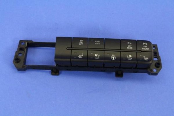

Can you use the blank switches on the interior switch panel? I have a Laramie, so heated/cooled seats, heated steering wheel, tow switch, etc. There are a few blanks on there and I would like to use one for some aftermarket lighting. Is this something easily done?
I know one option is to add the Aux Switch panel and control all the climate stuff from the touch screen, but I'd really like to keep the switches.
Is this doable?
Has anyone ever done this?
Are the necessary electronics behind the blank or would have I have to add them?
If so, where do I find the output in the harness?
This is what I have (minus the parking sensors):
Is this doable?
I can confirm the switches are 100% behind the blanks, I recently purchased one like the one pictured and disassembled my factory (stability/tow only) to pull the blanks needed to eliminate the parking sensor switches and verified the switches are all there behind the blanks
Thanks, that's great info to have. Now I'll just need to determine if the pins are in the plug I have or not. If the pins are there, I just need to find where the other end of the circuit for whichever switch I choose to use is in the harness. To avoid hacking up the harness, I'd find the factory plug for say, the parking sensor switch, buy the corresponding other plug and wire that into my light relay. It'd be neat and tidy inside the truck.
It's not that simple. Many smart people have looked into this and I don't know of anyone that has added a switch to that panel. The only way is to replace it with a Aux switch style panel. (what I did)
I'm not at home so don't have my diagrams handy but I believe all of those "switches" on a standard panel are all LIN bus switches so you cannot just use them to control a relay. There are not individual circuits for each of those buttons.
I'll try to get the diagrams later to show you but I think you are wasting your time.

Here is the pinout for the switch connector. Like I said it's all LIN bus controlled with the exception of "AUX" switches if you have them. You cannot just use a blank switch, it doesn't work that way.

Dang. That's great information, but bad for my plans! I really appreciate you sharing it though. I had no idea it was LIN Bus controlled.

Out of curiosity, is the position the red arrow is pointing to a rocker switch in some RAM models?
Not that I've ever seen. It's just a spacer between the buttons and the trailer brake control slider, gives room for your finger to use the slider without risking hitting a button by accident.
