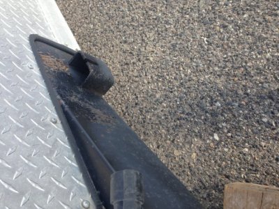

Going to be making a 1000 mile trip for our last race of the year in October. My v-nose has a tendency to dance side to side going down the highway, so I'd like to get a hitch setup before then to control it better. I'm not sure however what hitch or components I need to mount the brackets to the trailer. Can someone steer me in the right direction?

In all honesty, I don't have any experience with the v-nose trailers. I do know there are methods of attaching the WD brackets to the frame though. A lot of them are bolt on but could maybe be welded. It just depends on what you want.
Again, you can submit a message to the experts on etrailer and attach your pic of the trailer frame. Explain what you are looking for and what you want to achieve. I bought the Reese Straight Line from them for my Jayco Eagle and they were great to work with me.
It appears as your tongue already some weld on brackets though for a chain maybe for a WD system. I can't tell a lot though from the angle of the picture.

I'm starting to think I'm a complete idiot now that you pointed that out. I bet a chain link slides right into that slot so I don't need a bracket.
