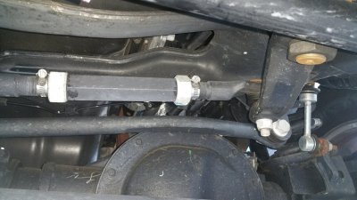

image.jpeg Welding these is ridiculous. For a few bucks, I bought stainless hose clamps and put one on each side. The nuts can't come loose. Easy peasy.

image.jpeg Welding is a ridiculous fix. For a few bucks, I put stainless clamps on each side. It'll never come loose. Easy peasy...

View attachment 188393 Welding is a ridiculous fix. For a few bucks, I put stainless clamps on each side. It'll never come loose. Easy peasy...
The nuts coming loose isn’t the root issue. The threads in the adjuster are the problem. If they’re oversized the drag link can pull out of the adjuster, skipping the threads.
So putting hose clamps on there may help the nuts from coming loose, it does nothing for the actual problem. Hence why FCA is wanting it welded. Welding the adjuster to the nuts essentially elongates the threaded section of the adjuster and has known good threads on either side of the possibly failed threads.
