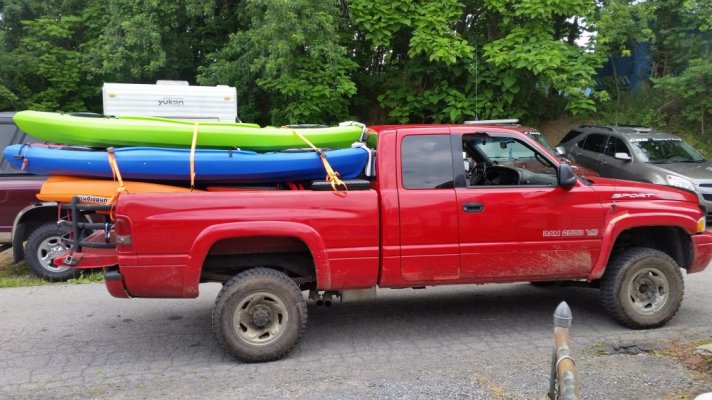

Mine is a federal V10 so it already has true dual exaust and 2 cats.
I ran dual turbo mufflers and currently have dual cherry bombs.
Love the sound of dueling 5 cylinders and it is loud.
Pictures are with the turbo mufflers...the cherry bombs fit up real nice
The HD setup only has O2 sensors upstream of the cats.
