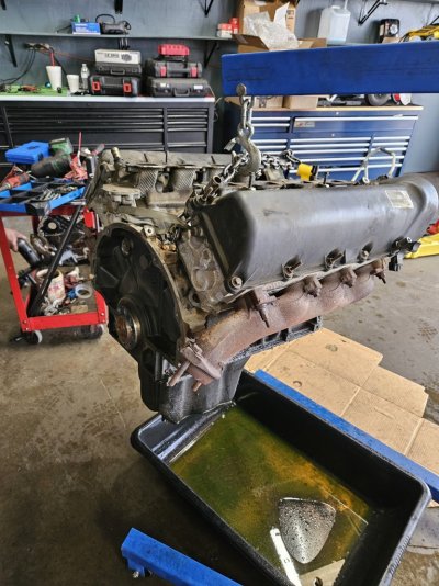

I started restoring a 2003 single cab with a 4.7. Doing the engine swap now. First of many steps and phases but looking forward to it!
I have a few upgrades I am doing since the engine is out like Gibson headers, upgraded aluminum valve covers, air intake manifold, K&N cold air intake.
And replacing so many things needed after 20+ years!
