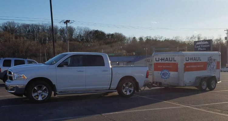

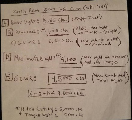

I'll repost this here for the OP too...
Here's mine 'loaded' down for a partial move today from our storage unit in VA back to SC 6.5hr drive. Still need to unload it this weekend ...
2013 Ram 1500 SLT CC 4x4 : 41k miles
V6/8spd/3.21
- @ 5200 lb truck
- @ 1000 lb payload approx.
(3 adults & son's college dorm stuff)
- @ 2500 lb 6x12 trailer
(Loaded with 2 roll around tool boxes, air compressor, 10kw genie, kit. table & chairs, bedroom set, lawn mower/equip., 7 ft serving hutch and a few other things)
@ 8700lbs total +/-
- 65-75 mph more of the way, 10.8 mpg avg
(vs 17/22 normally)
- tow/haul mode w/ top gear limited to 6th or 7th depending on conditions.
- Aired the stock 20" SRA's to 42lbs in rear/41lbs front
Yeah, the Pentastar does just fine for my needs and has been very reliable so far.
(She's got some squat on her)

Thanks for posting this, mine is similar except I have a QC. This is about all I would ever need to haul and tow and its good to know it handled it fine. I've had the bed loaded down with furniture many times, but never had to tow anything. People tend to forget that V8 trucks of 15 years ago were making similar numbers as the V6 trucks of today, and they never seemed to have any issues towing/hauling.
