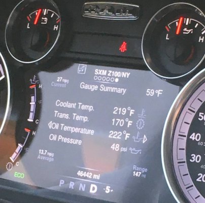

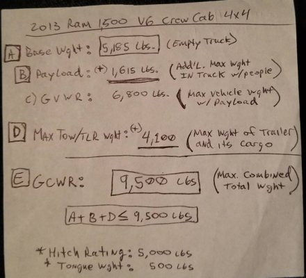

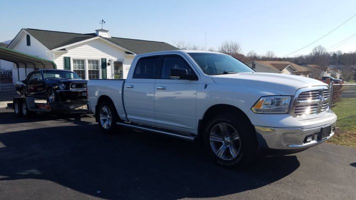

---------- 3/23/18 update ---------
So here's another 'factual' update for those that would consider the v6 Pentastar for mileage & occasional towing.
(v8 is still best for towing but the Pentastar will get the job done when needed)
2013 Ram 1500 SLT CC 4x4 : 47k miles
V6/8spd/3.21
Roanoke VA to Anderson SC. 330 miles, Appalachian mountains, i81, i40, 321, i77, i85.
- @ 5200 lb truck
- @ 400 lb payload approx.
(2 adults 2 days of luggage)
- @ 2100 lb 6x12 Car trailer
- @ 2700 lb 1968 Mustang GT
(5200 lb payload/towing)
@ 10400lbs total +/- ( about 900 lbs over)
- 65-75 mph most of the way (interstate) 13 mpg avg (vs 17/22 normally)
- tow/haul mode w/ top gear limited to 6th & a lot of time in 5th and a few times at 4th going up a grade (Fancy Gap, VA).
Truck showed its capability, and did well for the load. Definitely at max though.
