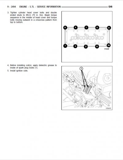

Not speaking from personal experience on your specific engine, but in general, torquing valve covers properly is often overlooked and leads to leaks. Be sure you have the right torque wrench for the specs.

Do tell what you get for gasket brand and any special tells for getting the huck bolts (the ones that make you swear)
Cost in August / September USD?
I always go the extra and uses thread lock blue medium 242. The last thing I want frustrating me and making a mess is a bolt that vibrates out a smidge and later starts to weep oil again. I can confidently park on anybody's driveway without concern for leaving a mark.
