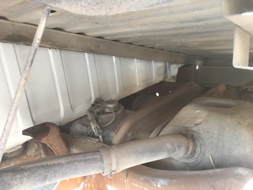

This weekend I’m replacing the fuel pump on my Ram. Going to do it by either tilting the bed or lifting the bed completely off... don’t want to drop the tank. I’ve watched a few videos but some prayers would be nice! [emoji16]
Any suggestions or tips would be greatly appreciated!

New fuel pump installed. Lifted the bed by removing all but the rest most bolt. 4 hours. Had helpfrom my most awesome friend Ray!0501b476a85530a61a8c54db6cf5d64d.jpg075449a25e0f161ad9798835cc614358.jpg
