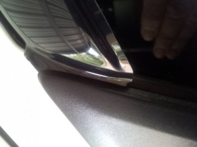

The only pics i have dont show that part...i will try to get some soon.
hemi8lonestar
May 10, 2013
106
55
Hemphill, Tx
2017 2500 Laramie
Hope this helps

Thanks for the pic. AVS is sending me some more of the adhesive tape, so I just need to figure out if I want to pull them out and reinstall.

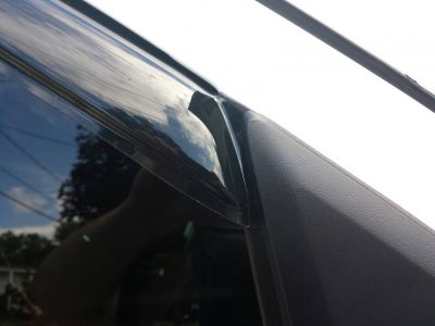

I did it the way it says to and went between the mirror and trim. I was reluctant but it actually fits nice.

How far does it push out the plastic mirror cap? That is my one concern.
Doc221
Jul 15, 2013
285
53
Central NJ
Not near as much as I thought it would. Its a tight squeeze. I had to use my fingernail to pull out the top of it enough to get it in. Makes for a nice tight fit though.
