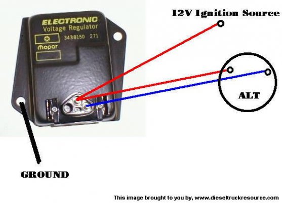

I have an 1985 W150 that caught on fire and I rewired. Well when I rewired I did not hook back up the voltage regulator from the alternator and have no clue where the wire goes from there. Any help is appreciated.
