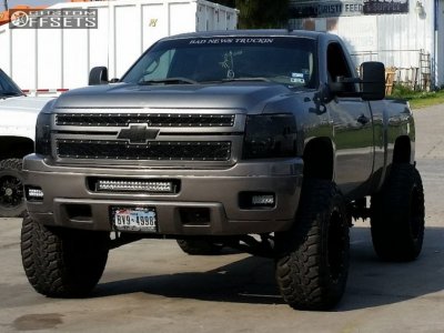

hey all currently running a zone 6" suspension lift, with
37x12.50R20 and the rims i believe from what i seen are 20x9-1 ? XD811?
currently got bushwaker fender flares and the tires dont go past it they are under it, i want that stick out stance..nothing too stupid but just kinda normal i guess lol? whats the best option here i might get a new set of rims with a decent offset just dont know whats common to run. Like can i run new rims with new tires? something fatter than a 12.50? or bigger than 37's? or 37's that are wider. with a good offset rim....hopfully you guyes can understand what im saying here ! :)
2015 ram 1500, sport crew.
provided a picture on what i kinda want! :)

wow is that a 1500? on a 6" lift ? do you rub at all? or do u get more clearance lol.
Jameson
Sep 11, 2010
547
173
Fort Benning, GA
It's a 1500 with 6" Pro Comp, Coilovers cranked to 8.5" and 1.5" body aloft. I don't rub.

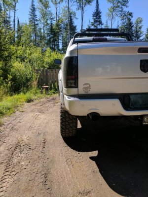

Just be cautious if you go with the -44 offset, which appears to be what you posted, you may not clear. I'm looking to go with 37's on my 20's which sit under a 6" procomp lift on a 2014 crewcab with the -44 offset. I am not going to clear 37's on a turn. My valance had to be slightly shaved to clear the 35's when they were new. Jameson has a total 10" lift, but you wouldn't need that much to clear. I would just make sure measurements are taken first, you might be able to pull it off. I'm seeing some newer 1500's sitting slightly higher on a 6" lift, compared to mine and I suspect my front is sitting an inch lower. Gotta take off my flares and measure to be sure.
Here is a pic to give you an idea of what I am talking about. Keep in mind, these 35's are at about 30 percent tread remaining.

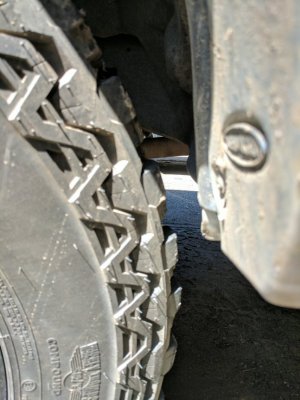

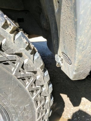

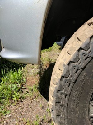

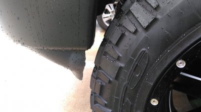

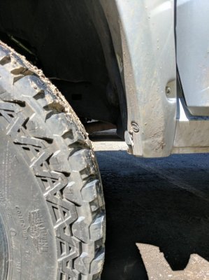

heres some pics of current wheel cranked and how much is currently sticks out.

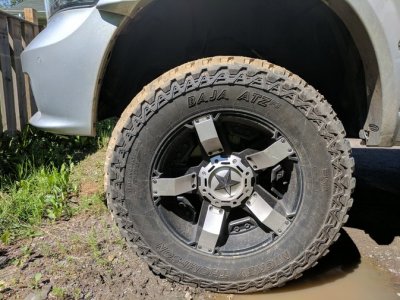

more
