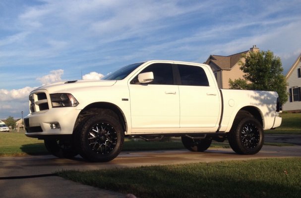

Zone 4"F/3"R with Bils set at 1.4 on 35 x 12.50's .... Still fits in my 7' garage door, and most parking garagescb1cd99e611550bd2d850f4307560e4f.jpg

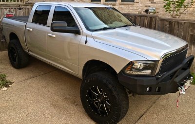

I had Bilsteins 5100s and just swapped them to beefier 6112s. I run a 6" Zone lift and run 37 Nitto Ridge Grapplers.
