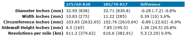

If your current tires are 275/60/20 the go with a 285/70/17, those are pretty much the same diameter and your speedometer/odometer will be correct

The OEM tire sizes are not required to maintain speedometer accuracy, you can use a tire comparison calculator to get the circumference/rpm* within 4%.
* That rpm is for revolutions per mile.
Or, if your tire of preference has a different circumference (more than 4% difference) and/or maintaining the speedometer accuracy is important, AlfaOBD will allow you to tweak sizes to perfection.
