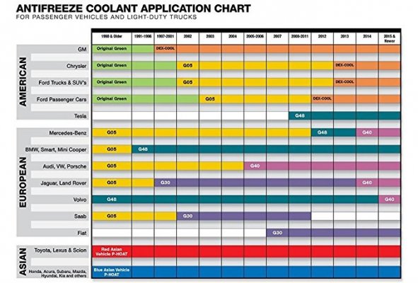

The problem is there is no way to flush modern cooling systems. In our application the drivers side block bolt isn't easily accessible, so to do it right, you will need to add demineraled water until only clear water comes from the bottom of the system, then add concentrated mopar hoat until correct mix %. Look at bright side, it was likely time to update coolant anyhow yes?
verify you are hoat which is a great coolant btw, the 2012 was right on the line, is your coolant orange?

My coolant is probably orange now, since the washer fluid was orange. Guess I’ll find out tomorrow.
