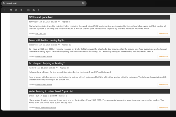

.. also, is this a new email format? Or is my Gmail just being retarded?
